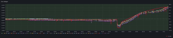

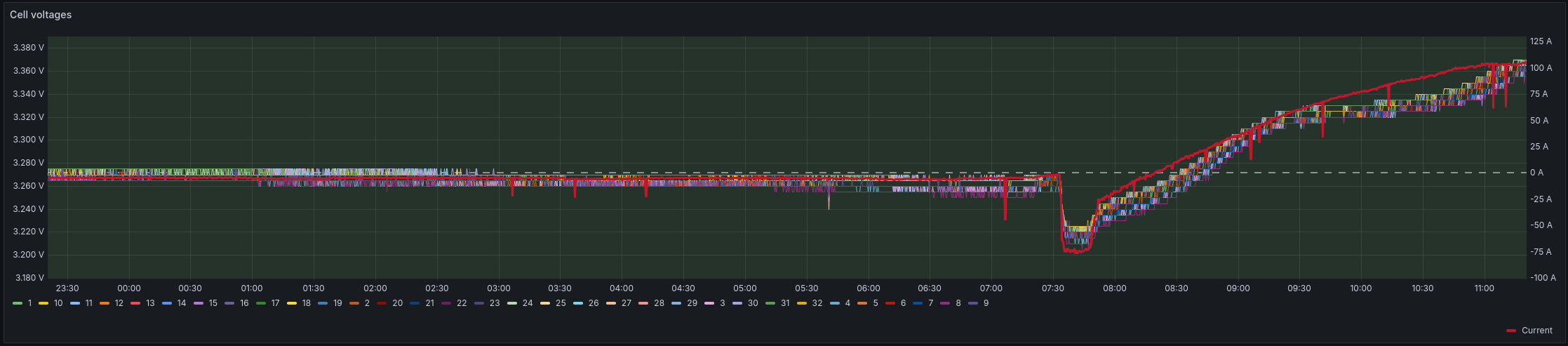

Hi @cadric,
I wanted to implement monitoring, too. As MQTT is currently not yet available, I deployed the WatchMonUdpListener and it works like a charm. Creating graphs and visualizations out of the provided data works very well.
Cell voltages and shunt current monitoring:

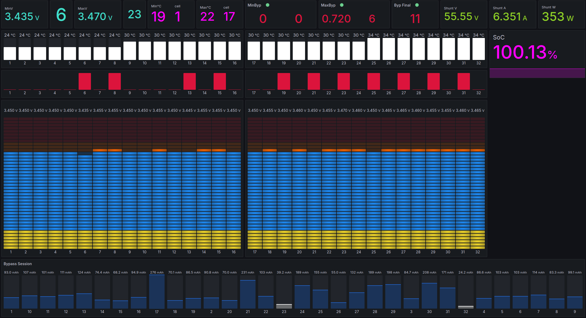

WatchMonToolkit like overview:

Hey Kleini,
thanks for the info, where do you use the data, is it Home Assistant or Graphana?
regards
cadric
WatchMonUdpListener can write data to MQTT or InfluxDB. Both dashboards are created in Grafana. The first uses InfluxDB as data source while the live view dashboard uses MQTT.
