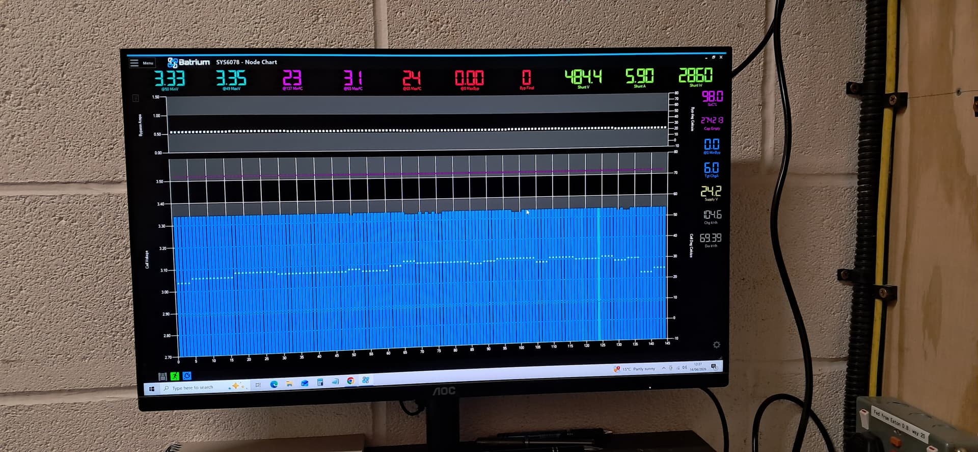

Sunsynk 50kW inverter that was initially paired with 96 280Ah batteries. I have now added another 48 305Ah batteries all controlled by Batrium watchmoncore and 9 cellmate K9’s.
The initial balancing was speeded up by discharging some cells with a 300w wire wound resistor pack and boosting some cells with a 300w power supply.
Even though the cells are different capacities the batrium maintains the top balance really well but obviously the overall capacity is limited by the 280Ah cells.

Good to hear that Watchmon Core + CellMate K9s are no problem with large cells(your screen looks nice!). That answers my question for the 314Ah MB31 cells. I’ll make sure there is good airflow for the K9s.
