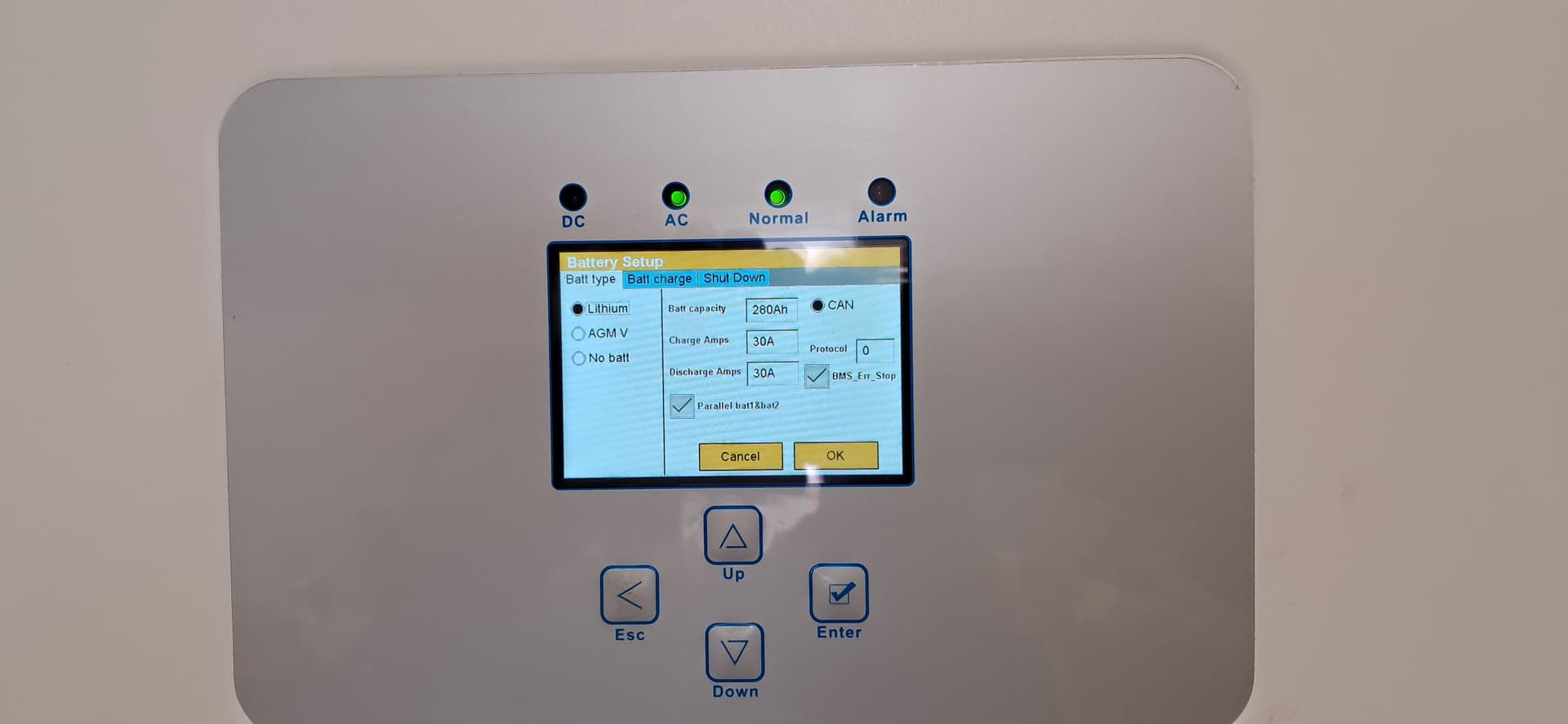

Hello, now i have a running system with the handicap that the charging and discharging of the battery is limited to 50 Ampere, i conected from the kilovac two cable to the inverter so i want to use both battery channels of the inverter. to have 100 Ampere. My cells are 64 MB 31 so i can discharge just 11 KW with the one channel. 22 KW will be fine. Do you have an idea to manage this in the settings? Best regards Matthias

Does your inverter have one CAN port or two?
You will likely have to configure your inverter settings to expect 2x batteries in parallel.
Can you show us what your configuration app for your DEYE presents as battery options for parallel?
On the sunsynk you can set the battery conections to parallel in the battery settings and have 100amp.
Hello, i loaded the solarman pro app and installed it, but there is no option to change to parallel, i am stilll with 50 Ampere. The AI said its not possible to make 100 ampere with the Deye Inverter. Iook like i have to change it. The Sunsynk is the better option? Or Solinteg - MHT-30K-100 ? Best regards Matthia
