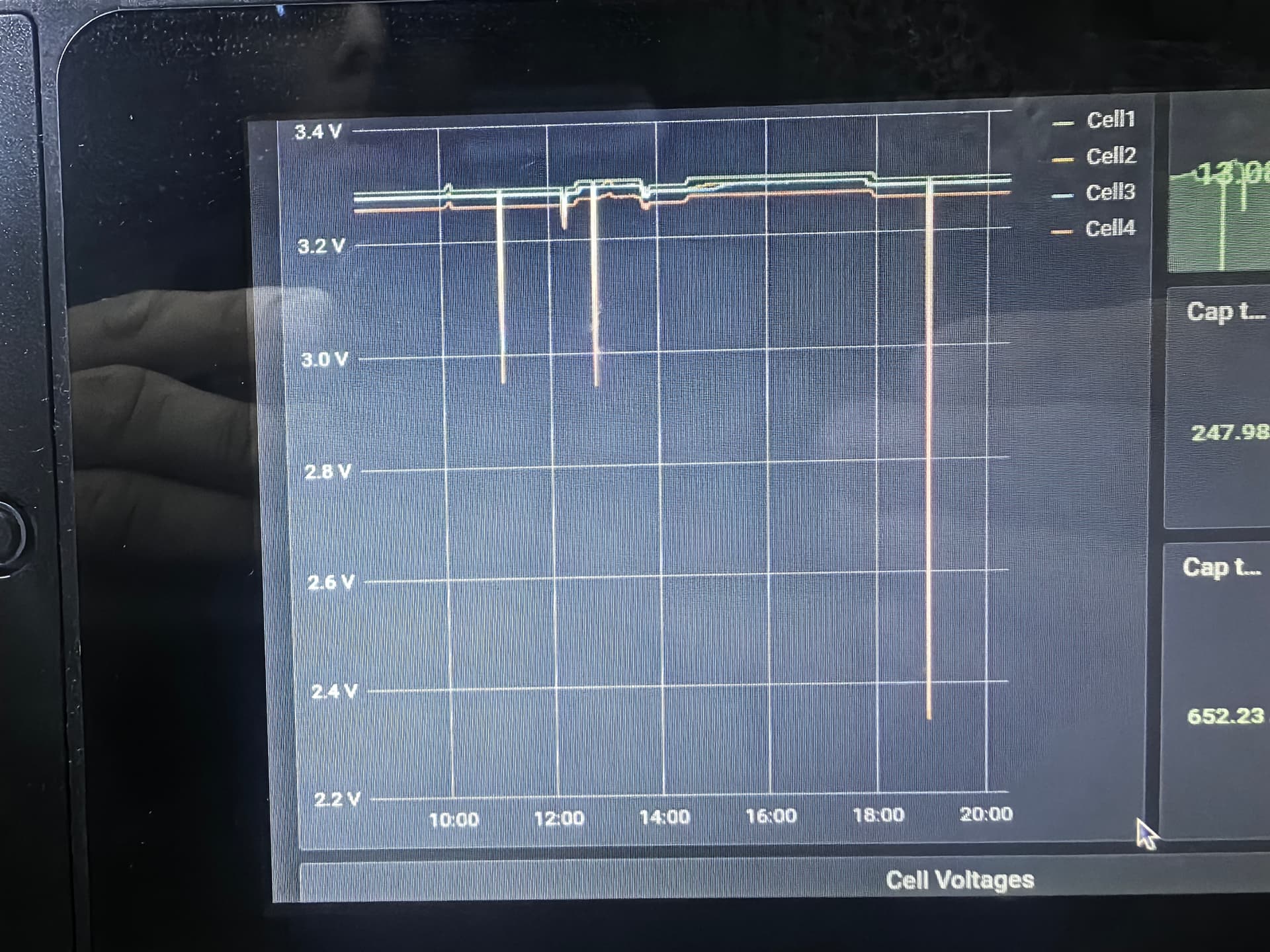

This was today. using 5-10A the entire day. As you can see, all 4 blockmons dipped 3x. The interesting thing is that each blockmon is in a separate battery box and independent. I’m going to tear the whole thing apart next week.
Do you have anything monitoring current
Yes I do. I’ll take a picture the next time the event happens. It usually happens during a low current event. Each of these cellmons are connected to 5 180ah cells in parrallel. It takes a lot to bring them down.
