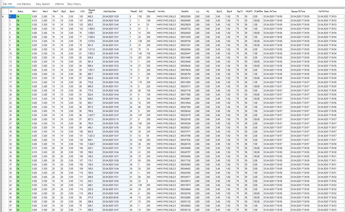

Also Cell Info everything is clean:
I don’t know where else you can look to find errors?

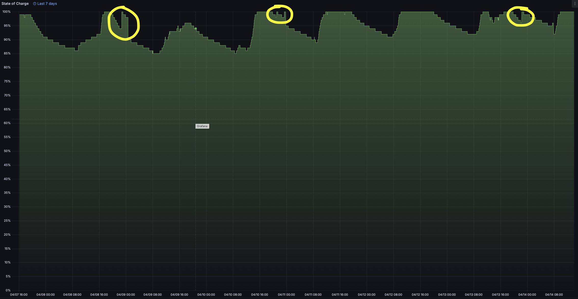

Happens in the period 21:00-00:00. But not every night either!

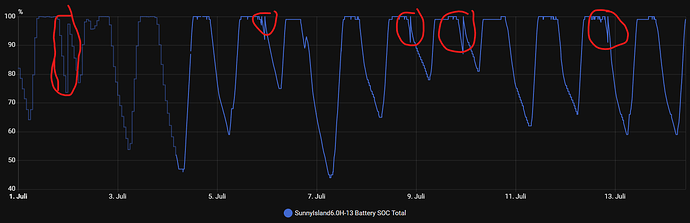

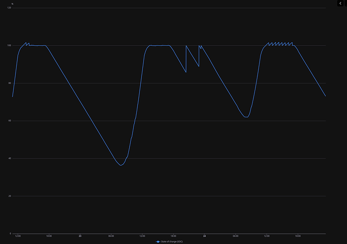

I have the same issue. It jumps back to 100% while discharging, so no Re-calibration should happen. Sometimes it’s from 90% to 100%, sometimes even as far as from 70% to 100%. Happens almost every night:

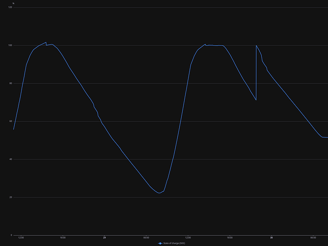

Hi, I have from what I read a similar issue with my 15kWh LiFePO4 Solar setup with a Goodwe GW-5048D-ES. At irregular interval (1-9 days) the SOC will reset to 100% during discharging. I checked/cleaned every connection, reboot etc. but no change. I’m on 2.17.57. First occurrence Oct. 27th and has since then happened 15 times. Most are a singe back to 100% reset, some are multiple resets closes together.
I have some observations:
  • It only happens after 100% charge was reached, never happens at lower SOC peaks.
  • It only happens on the discharge cycle (in full darkness)
  • Clock is set correctly
  • No changes to the system (4 years in operation), only changes is software updates
  • Disabling re-calibrate Hi, Low and bypass SOC has no effect on this issue

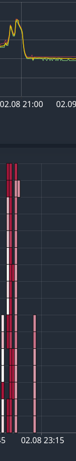

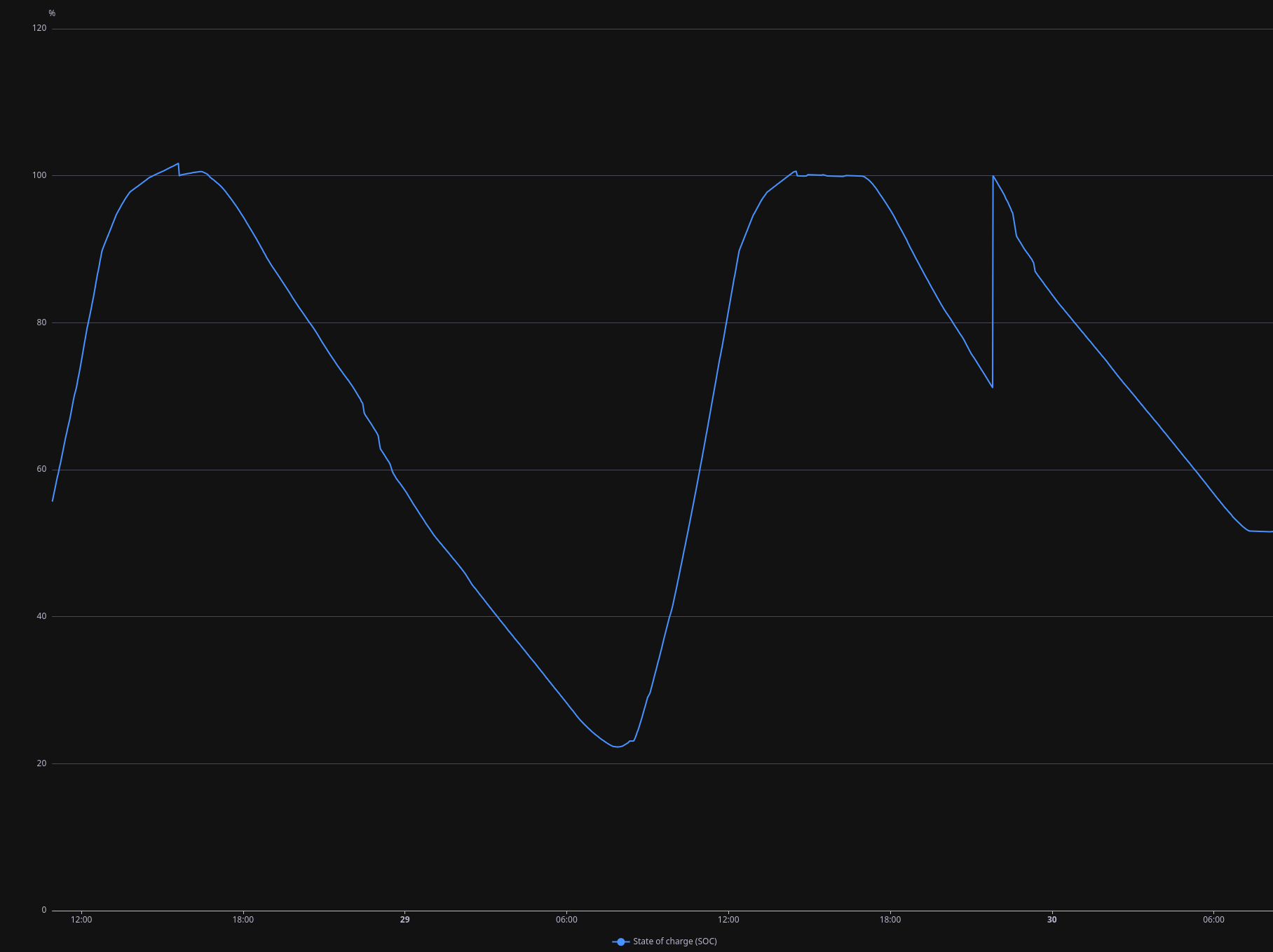

This is an example of a single reset at 21:44 (Full dark in Thailand) at SOC of 71%.
On a reset my batteries will drain to the low cut-out then then never charge full again unless I reset the SOC manual. If anybody has any suggestions or if I can provide specific data let me know, whas hoping the issue would go away but doesn’t seem like it.
This is an example of a multiple, first one at 20:26 @ SOC 86%, then 22:53 @ SOC 89% and finally23:16 @ SOC 98%

Hi Everyone,
I’ve taken a look at our inner workings and Mario’s system, and can confirm these are the only two reasons SoC% will be reset to 100% from below (i.e. not the 101.5% mentioned above):
  1. If all cells are bypassing at a rate above Bypass Final CA2 (defaults to 300mA) or
  2. All of these conditions are met:
    a. All cells have balanced by at least 50mAh (set by CA3) AND
    b. at least one cell is currently balancing AND
    c. either a cell is over CV9 or the cells are flat (below delta configured in Auto Level settings)

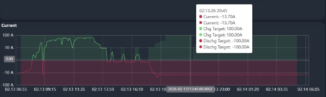

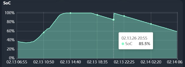

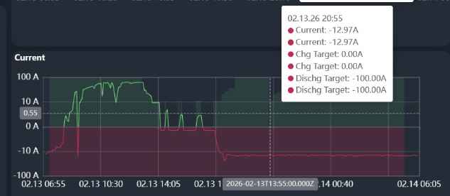

Now, in the event I can see in the data we have in our logs, all cells have reached CA3 during a reset, but balancing shouldn’t have been occurring.
Did you manage to catch what else was happening to the system at the time? A charge current spike that pushed the cell voltages up for some reason?
