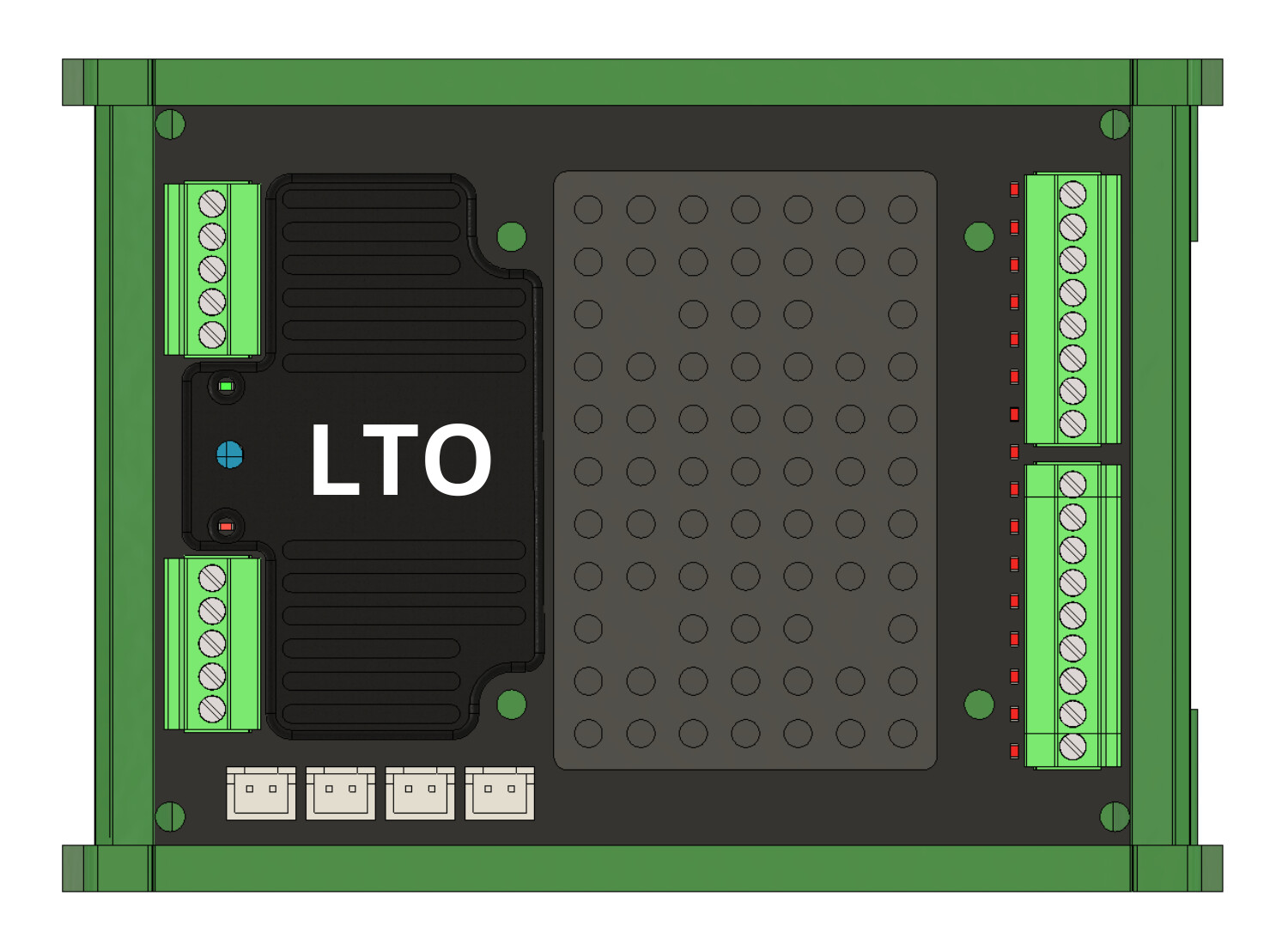

Definitely go with our K9 LTO on that one - Our BlockMons/LongMons will stop communicating at 2V, so the chain will go dead as soon as one reaches 2V.
This will trigger a critical event, we won’t be able to monitor cell voltages and temps, and throw your circuit breaker if you have one set up.
