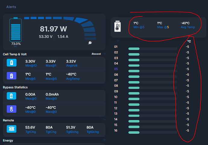

I’ve noticed that below 0 °C, Batrium shows a temperature of –40 °C and begins to display correctly only once the temperature goes above freezing.
When this first happened, I began to suspect the NTC sensors, but now it looks to me like an incomplete implementation of the NTC sensor characteristics in the firmware. But, even if a 3950 NTC sensor becomes inaccurate below zero, it’s still better to have a reading than to have no reading at all. Maybe it would be a good idea to select an NTC with a different Beta values from the dropdown list?
The lack of continuous temperature measurement is a major inconvenience when operating a photovoltaic system in a colder climate.

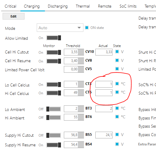

What’s more, the Toolkit software allows setting any temperature below zero in the Thermal Control tab, but the sensor only provides feedback down to 0 °C — below that, it jumps straight to –40 °C.
At least that’s how it looks in my case :thinking:
I’m rather annoyed by Batrium’s temperature readings. The system is considered a high-end BMS, yet in this area it behaves like a cheap Chinese one.

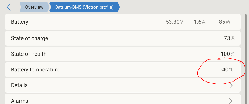

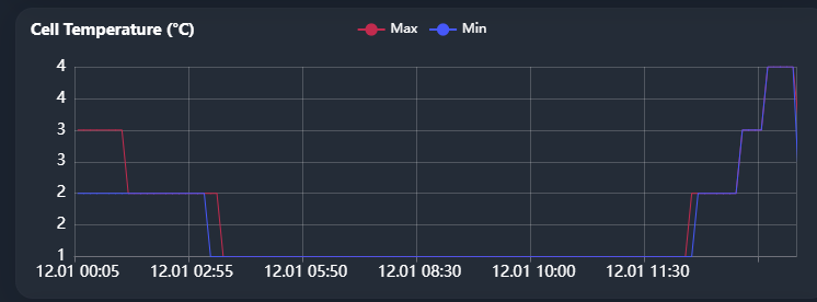

The actual battery temperature is around –1 to 0 °C, but… a temperature of –40 °C is being sent to the Victron system, the Toolkit software shows +1 °C, and in the BMI the min and max are both +1 °C — yet the average is somehow –40 °C. Meanwhile, the temperature of each individual cell is shown as –5 °C.

I’ll run some tests in the freezer to confirm this for you, it’s true that B3950s get less accurate below 0, but -40 is the same reading we get when it’s not plugged in at all :thinking:
Expect a response in a couple of days
Hi wmichale,
Ran some tests today, and couldn’t reproduce that strange temperature behaviour
This could be due to a weak freezer in the office, but I think the test was worth it anyway.

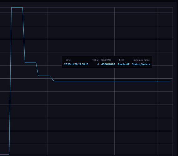

Could you please email info@batrium.com with your WatchMonCORE serial number, and make sure it is provisioned, and we’ll take a closer look at your logs over there.

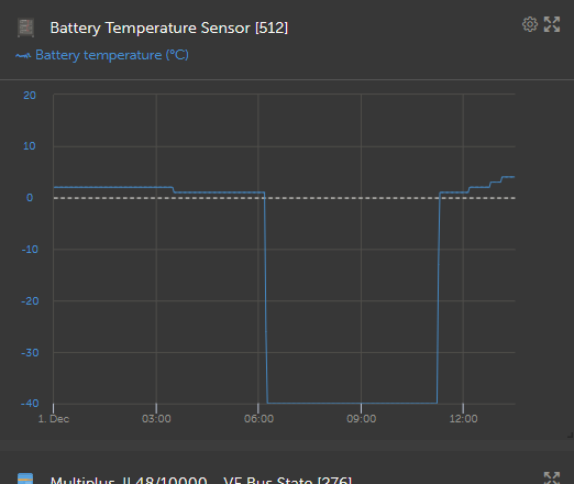

This is a situation from this morning when temperature of the battery dropped to 0 — both the Victron and BMI screenshots cover the same timeframe.
I’m glad the matter was confirmed and that I didn’t create unnecessary drama :wink:
