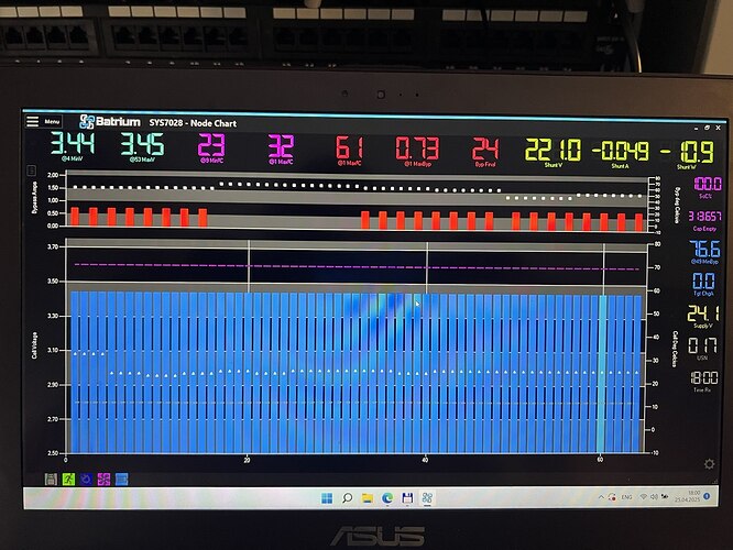

My charge voltage on the inverter is set at 350v but the batrium never gets above 330 - 335 v
Once the battery gets to 100% SOC the inverter shuts off until there is a need for discharge.
