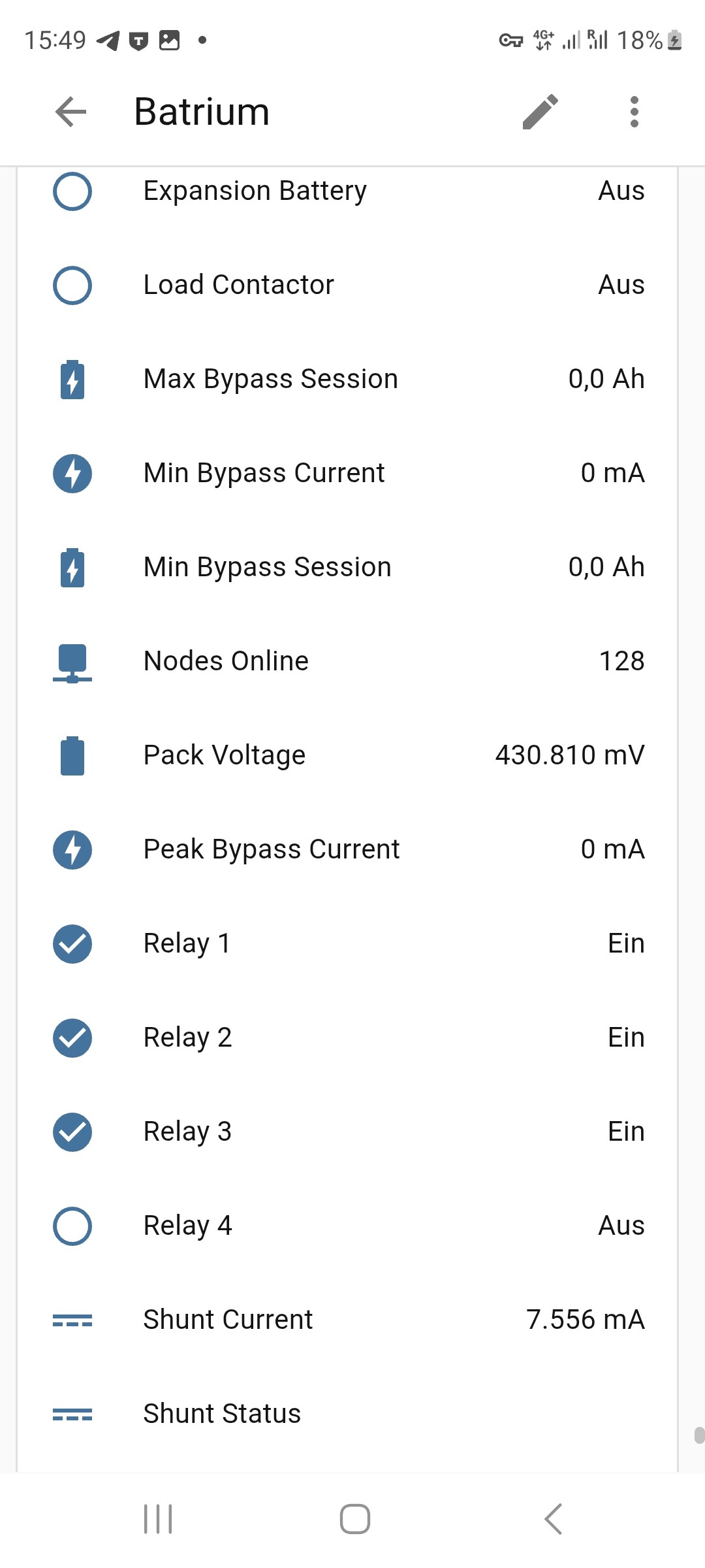

I was able to integrate it without any problems, and it works very well. Thank you!
What I’ve noticed so far that doesn’t seem right is: Home Assistant shows ‘Pack Voltage: approx. -226.530 mV’, while Watchmon shows 428.8V.
Could you please check if there’s anything that can be done about this?
Hi
Glad you found it useful, you are using a very different setup than me, mine is a nominal 24v pack my guess is it’s an overflow in a calculation of some sorts that would never show on my very low voltage system.
Before I dig further can you give me a bit more information about your system. Which Batrium modules do you have, how many cells in total, are you using the K9 with the watchmon or Longmons.
Finally are there any errors in the log page of the add-on?
Ric
Found it !
It was an INT16 calculation max value 32767 but your pack voltage at 428.8v would have been 42880 thus it overflowed.
I’ve pushed an update should be live now but HA only polls every 24 hrs, if you want to force it go into the addons, add-on store and click the three dots and select check for updates.
Regards
Ric
Thank you very much, it worked. :slight_smile:
