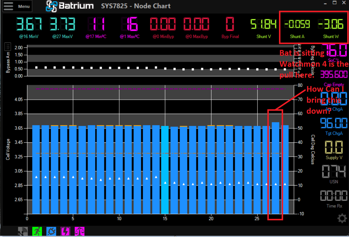

If this is off-base, no problem but along the lines of “how does balance work”… Mine is a Watchmon 4 with longmons. I have pack that’s 60mv higher than the rest but the battery is ‘at rest’. It’s my camper and there’s no charging or load other than the Watchmon 4 - it’s stitting in storage till the next camping trip. Each blue bar is a 260ah pack.
I’d like to balance down that ‘hi’ pack but when I do Auto-Level the red bars cycle around and seem to skip over the hi pack - e.g. I don’t see that Auto-Level is ever going to bring it down to the rest. And from reading the help it sounds like one can’t balance (either Bypass or Auto-Level) when there’s no charge going on?
Would be interested to better understand how things work and is there any option to do balancing with no charge going on.
