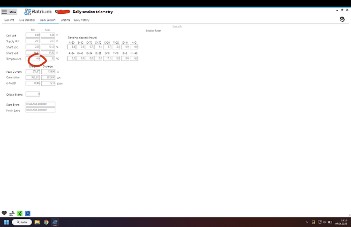

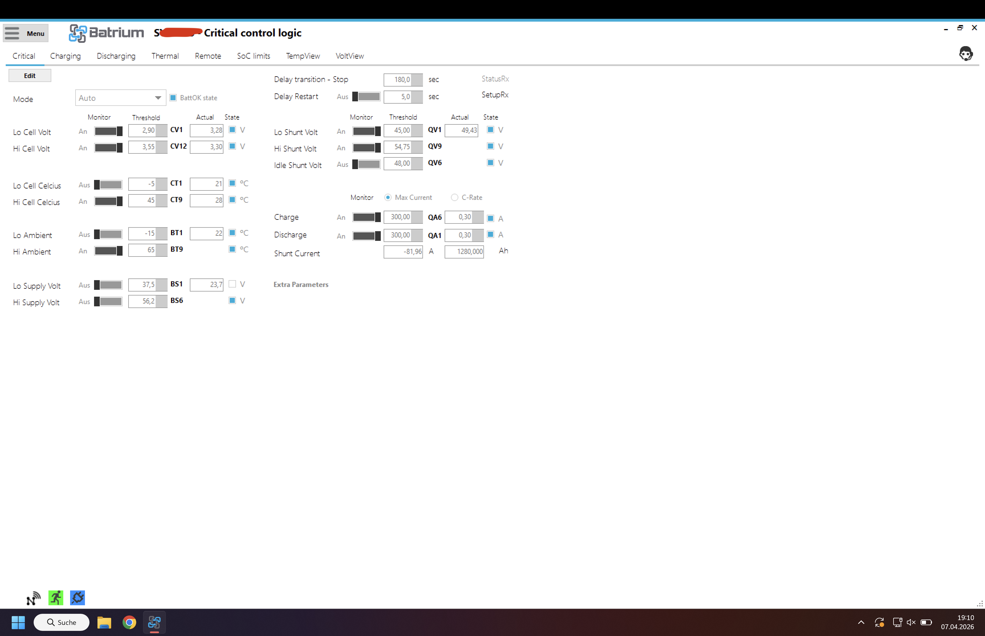

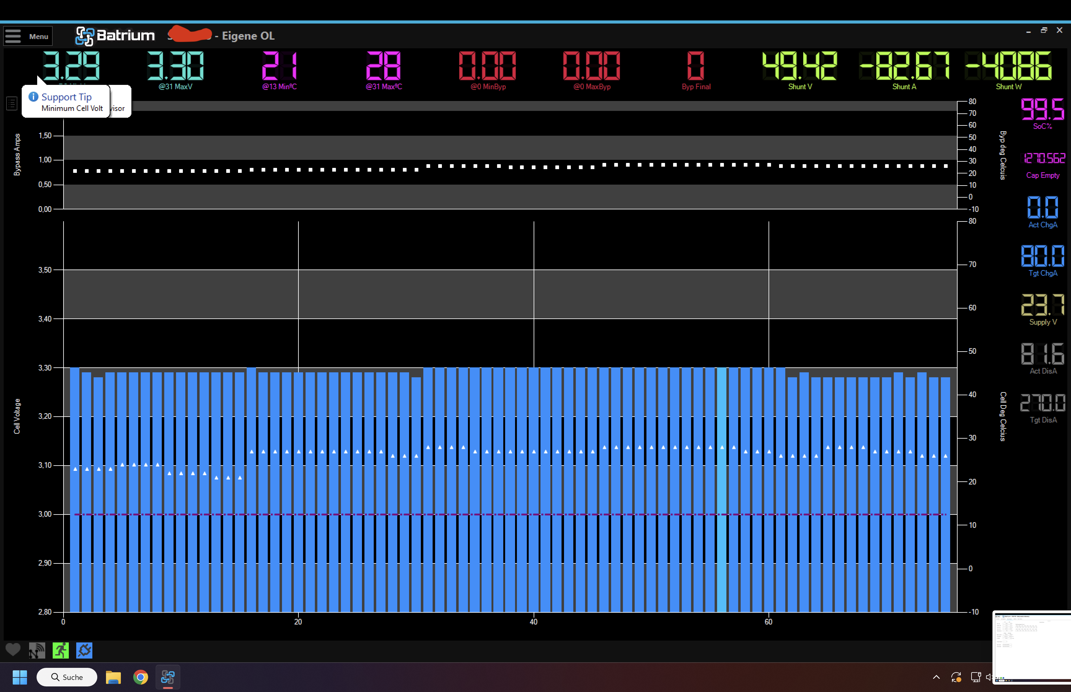

I have the following problem: when the storage is nearly full, a critical event is triggered at irregular intervals due to a temperature reading of -40 degrees from an unknown source. I cannot tell whether it comes from the BMS or the Cellmate-K9. As a result, the storage system shuts down, and I have to restart it manually every time. I have been experiencing this issue for about four months.

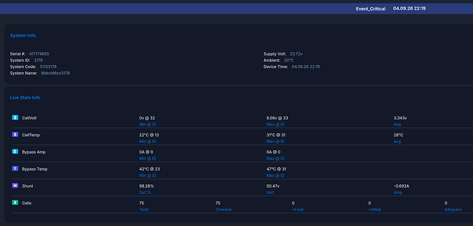

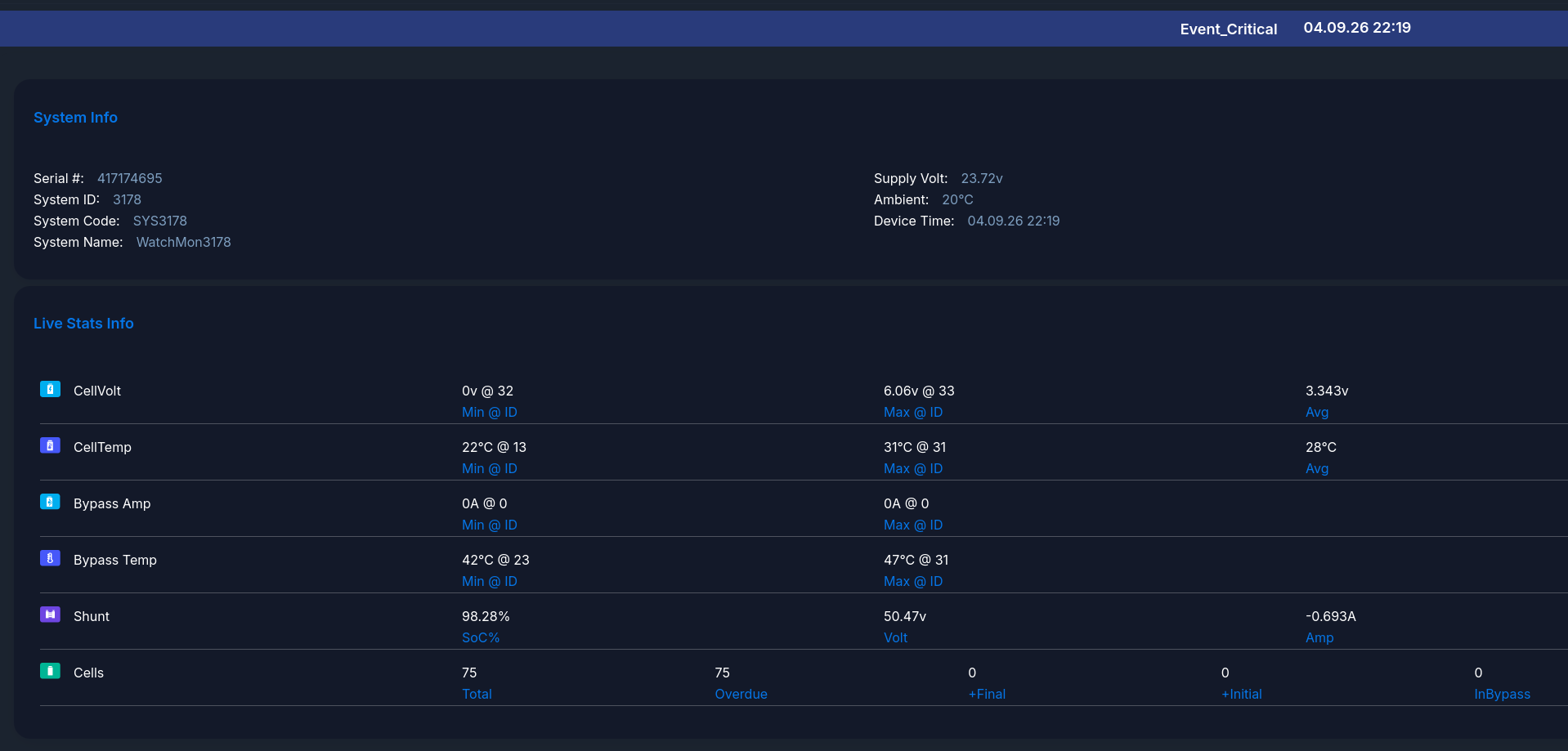

Now that you have sent me your serial number, I took a look at your system in bmi.batrium.com in a read-only manner.
I can see a few critical events recently, in the most recent event, you can see the real issue: briefly, cell 32 went to 0V, and cell 33 to 6V. In reality, both cells are both likely at around 3V, but a loose link between cells makes it look to our BMS that this huge swing is happening
Could you please try:
  1. Disconnect the connectors on the K9(s) that manages cells 32 and 33
  2. Tighten and check the links around that area (being sure to respect the torque specs in your cell manual using a torque wrench)
  3. Reconnect the K9(s)
