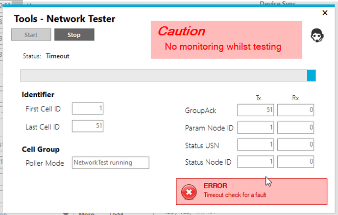

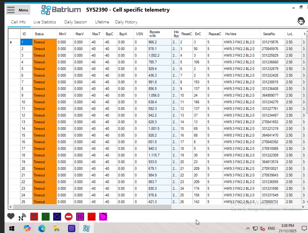

ok, it has finally happened when i have been home to look at it.
There are no flashing lights on the celmons. and i confirmed again that the only way to repair is to power cycle the WM4 by physically unplugging it and plugging it back in. Even a reboot from the toolkit does not help.
Any suggestions on where to go from here. As this is a critical part of the system, i cant have it keep going down like this. it has happened 3 times so far in 2026.

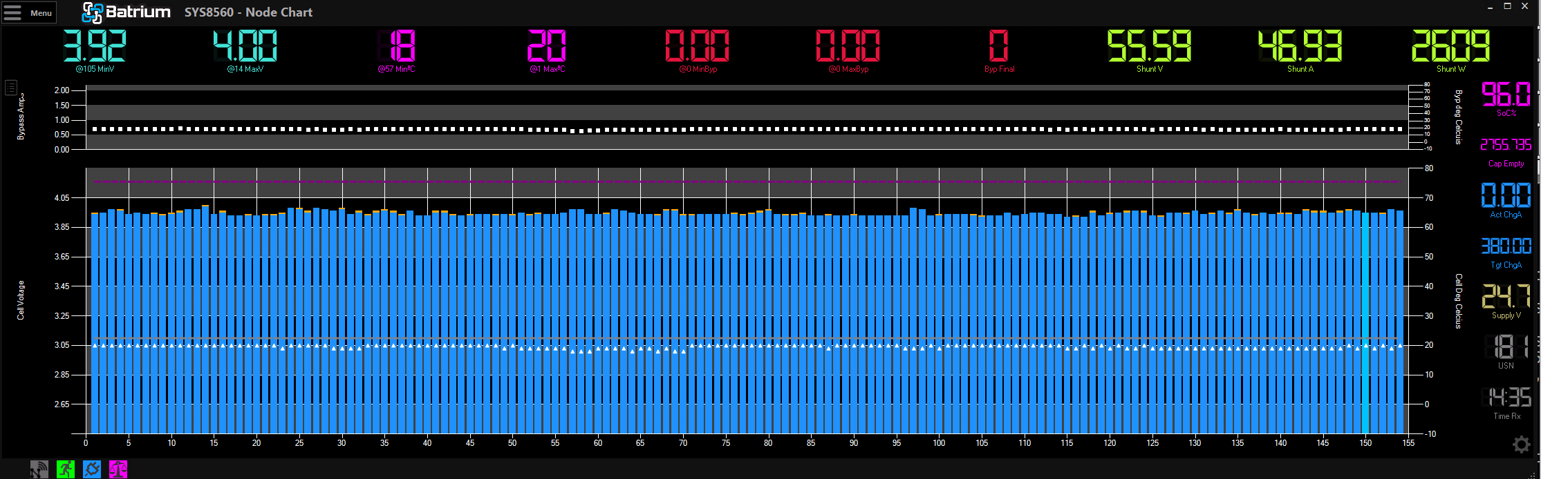

Sorry I didn’t see this till now. I’m up to 154 longmons on my home powerwall (8yr old Watchmon) and 14 in my camper (5yr old Watchmon) . The system works very well except for extreme (humidity) weather changes as I noted above for home powerwall - and I’ll get a ‘freeze’ at one of the longmons until I wiggle the connector - and then things resume. The camper, with newer Watchmon and only 14 longmons has never frozen or hiccuped over 5 yrs - pretty robust - we keep it powered 24/7 all year.
I occasionally get ‘temporary (2secs) bad voltage reading on a longmon’ when doing Auto Level, on the home powerall but my monitoring software handles this so it’s not a problem. Plus I only need to Auto Level for a week or 2 every 6 months - the rest of the time the 260ah packs are close enough.
I operate between 3.5v and 4.0v (lithium-ion is 3.0v to 4.2v) so the system can handle up to a 200mv max difference safely - but mostly I’m able keep things <100mv with no trouble.
