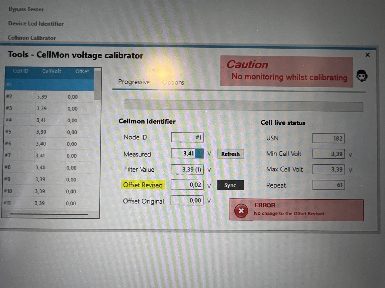

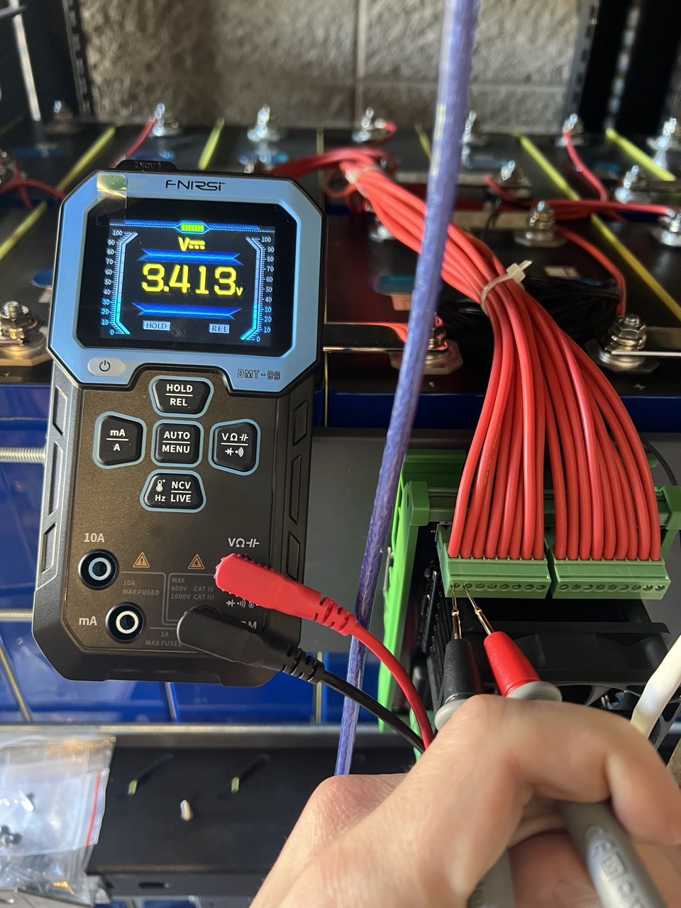

I noticed that the voltage on my K9 pins does not match what Batrium shows. Here’s an example:
The first cell in monitoring = 3.39, but in reality, 3.413 (and this measurement is not even on the cells, see
I wanted to use the calibration mechanism and found the relevant topic on the wiki CellMon Voltage Calibrator | Batrium Knowledge / Wiki,
but I encountered an error, ‘ERROR No Change to the Offset Revised’ (see ).
Could you please advise where I went wrong in the calibration procedure?
Cell voltage calibration is not possible at the moment AFAIK.
I have a similar issue as you. In my setup the sum of cell voltages in different packs differ and make it hard to reach bypass session of 50mAh for each cell.
I have the same issue with the voltage reporting. Have you made any progress on the matter?
Try this it worked for me.
in the voltage calibration tool click on options
change the Min Repeat value to a low number 10 > 2
then run your calibration procedure.
Unfortunately, the calibration does not work, but there is something to calibrate - the spread with the actual values ​​is about 0.025v
maybe there is a video instruction on how to perform calibration correctly?
