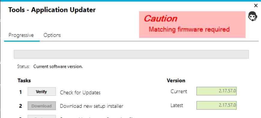

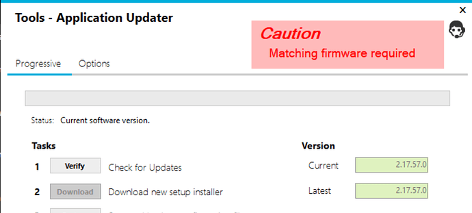

running latest WMTK also
Which version of WMTK were you on before updating to 2.17.57?
thats a good question. I cant answer that, as the system came to me with a bunch of other stuff i purchased. so i dont know what they were using previously.
@Doskobaba Please read your linked page a little bit further down:
It clearly states WatchMon Toolkit 2.17.57 for WatchMon4.
Thank you for pointing that out.
