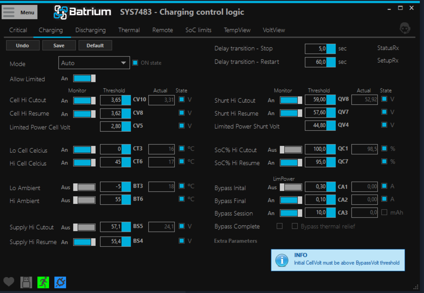

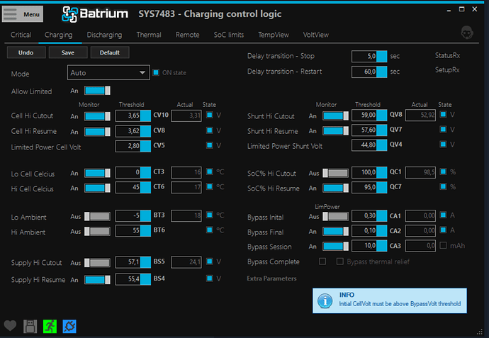

I want to set a different Bypass Session Value because i have also connected an active Balancer.
But everytime i try to set a different Value and press Save i get an Message beloww and cant save this Value.
im not able do find the Values i also have to change to save this Bypass Session Value.
Can anyon help me find the Values mentiond in the Error-Message?

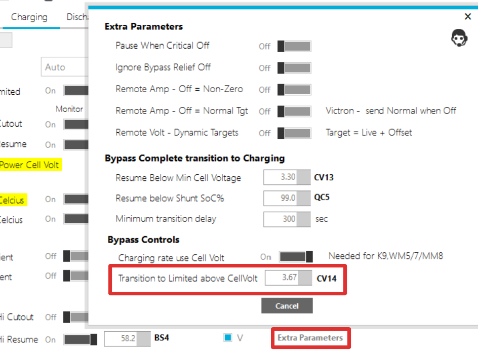

This error is referring to CV14, which replaces CA1 on K9 systems:
So CV14 must be above CV9.
